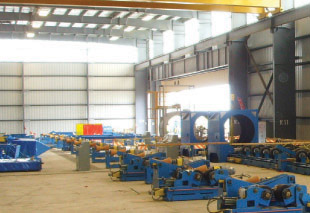

According to Kravec, the approximately 350,000-sq-ft pipe mill features an abundant number of translucent panels installed within its exterior walls. Photocells mounted around the building's inside perimeter face the translucent panels and measure the amount of light entering the facility.

In addition, the lighting circuitry is arranged so that rows of lights can be shut off around the mill's indoor perimeter.
“We estimate 25% of the lights can be shut off during a sunny day,” observes Kravec. “After commissioning is complete, we expect even more lights will be extinguished.”
To achieve further energy savings, CDMG put considerable effort into selecting the proper lamps and controls. Using T5 high-output (T5HO) fluorescent luminaires, the company says it optimized the lighting system at 32% below California Title 24 requirements for watts per square foot.
“We found that, for this application, the high-bay luminaire we used was 18% more efficient than its closest competitor,” Kravec states. “This allowed us to use a symmetrical layout of three rows with one double fixture per column. The plant's lighting consumes just 0.75W per square foot to achieve a maintained 52-fc light level.”
