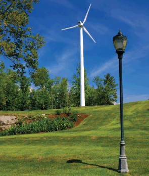

Stand-alone and utility-interactive, wind turbines rated 100kW or less are an increasingly important part of today’s renewable energy picture
Enormous wind farms, with individual machines rated in excess of 1MW, have dominated media coverage over the last several years, just as these huge turbines dominate the high plains and ridges across the country. But recently there has been a resurgence of interest in small wind turbines as well. While nameplate ratings are much less, advantages of these units include the fact that expensive and potentially controversial transmission lines are not an issue, making this option realistic for homes and small commercial facilities. In addition, smaller units (typically recognized in the industry as being rated 100kW or less) can be set up as stand-alone, battery-charging machines for off-grid usage or grid-tied electric utility interactive systems (Photo 1).
For small turbine installations, the power is used fairly close to where it is generated, and power lines are contained within the end-user’s property lines. Installation costs can be mitigated by a 30% tax credit, which was enacted on Oct. 3, 2008. The Emergency Economic Stabilization Act of 2008, H.R. 1424, includes a U.S. investment tax credit available for home, farm, and business wind power installations of less than 100kW capacity. This credit will run through Dec. 31, 2016, unless it is extended. For now, the credit may roll over into subsequent years or be used to liquidate a tax liability.
To qualify for the credit, it is necessary to document the cost of the system, when it was placed in service, and whether it qualifies in terms of system size and premises type. Homeowners should use IRS Form 5695, Residential Energy Credits. Businesses should use IRS Form 3468, Investment Credit. There may also be other state and local financial incentives available to further reduce the installed costs of such systems. Additionally, small wind turbine installations that feed back into the utility electric system are typically eligible to receive credit at the retail electricity price level.
As we have seen, the small wind turbine system plays an important role in the overall renewable energy spectrum. Wind is an abundant resource, and the know-how to extract electrical power from it is certainly within the reach of interested and savvy electrical professionals.
