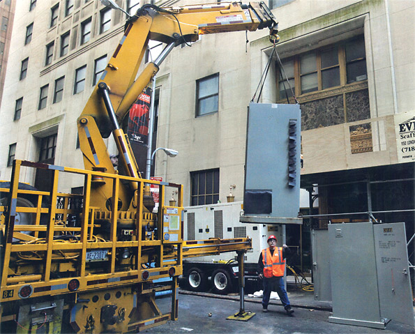

E-J Electric worked to restore equipment at a 27-story office building in the financial district of New York. All electrical service and distribution equipment was damaged by water from Hurricane Sandy.

At the entertainment and sports facility Chelsea Piers, the entire first floor, which contained the electrical infrastructure, was under water. E-J Electric Installation Co. crews were able to get the place opened in three weeks — in time to be open for its busy holiday season.
In order to do that, the firm cleaned and put back in service two 4,000A service switchboards, while simultaneously evaluating and ordering replacement electrical equipment for four major electrical distribution rooms throughout the complex. Three of these rooms were completely rebuilt, including the complete relocation of one electric room to the second floor to limit the facility’s exposure in the event of another flood event in the future.
In a second location, a replacement 500kVA transformer was installed on a 16-foot-high steel platform, and the remaining equipment was raised by 12 inches. In addition, E-J Electric helped determine a location for a replacement main service switchgear room on the second floor that is currently in design by the consulting engineers. Work will commence once plans are completed.
