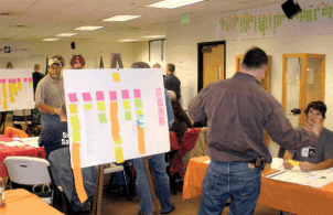

To set up the management of the labor, the project manager and labor supervisor start with the process of establishing a Work Breakdown Structure (WBS). The Photo shows the process of creating the WBS, involving several foremen, general foreman, and project manager for the electrical contractor on a real project. The WBS is created by first identifying all of the work required to finish the project. Then, the activities required can be categorized according to the two sets of criteria listed above. The electricians’ input is critical for the WBS creation, as well as for identifying the category of work and skill level required to complete the task. The WBS can then be used for other purposes of tracking the job from the foreman’s perspective, such as utilization of the ASTM Standard for Job Productivity Measurement (ASTM E2691).
