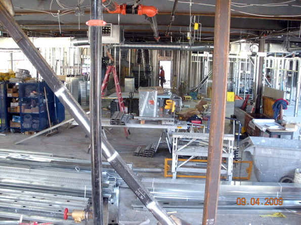

Walk onto many job sites, and it’s not uncommon to see extreme clutter everywhere (Photo 1) — and the same goes for gang boxes (Photo 2). According to in-house research from MCA, up to 5% of an electrical laborer’s time could be spent looking for tools and materials on the job site. Those lost man-hours in retrieving, handling, moving, and storing tools/materials can be extremely expensive. In fact, the cost of labor spent on material handling could be as high as 40% of the total labor used, depending on the job.
Photo 1. A cluttered job site without space for installation can be a dangerous work area.
