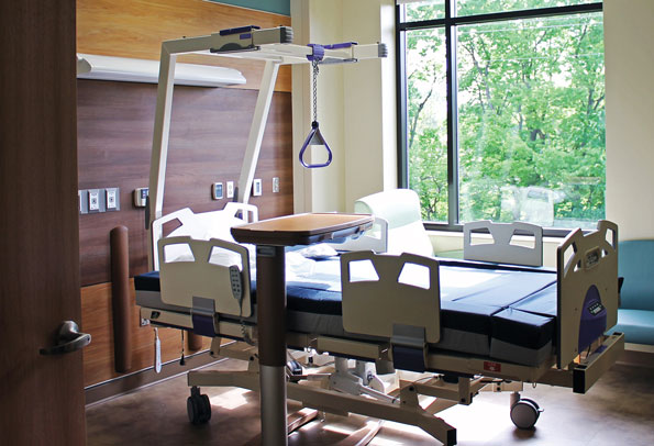

Patient comfort, security, and overall enhanced experience are leading to more high-tech systems in patient care rooms like the one shown here installed by ERMCO, Inc. at the Community Rehabilitation Hospital in Indianapolis.
