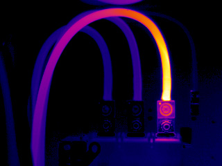

The basic concept and theory used to detect system anomalies is differential temperature, or Delta T. You should look for and compare like objects under like loads. In the case of a branch circuit panel, you may note that some breakers may be operating at higher temperatures than others. However, this may or may not be a problem. If one 20A breaker looks hotter than another, you should then take an amp probe reading to determine if there is more connected load on that breaker than the other. Any load over 80% of rating is considered an overloaded circuit.
The proper comparison wouldn’t be breaker to breaker, but breaker to buss and branch circuit connection, or surface temperature of the conductor insulation near the field connection to the surface temperature of the conductor insulation a few inches away. In a perfect world, if all connections were tight and had no resistance, the temperatures throughout this path would be at equilibrium and you wouldn’t have a Delta T. This same method is applied to all equipment, no matter what its type.
The most common differential temperature criteria used by thermographers today are those in NFPA 70B. This standard sets forth guidelines for differential temperature analysis and lists recommended actions based on those Delta-Ts. A Delta T of 7.3°F to 14.4°F (4.1°C to 8.0°C) falls into the alert category. In such cases, you should take action during the next scheduled maintenance cycle. The next level, 14.5°F to 27°F (8.1°C to 15°C), is classified as severe. This calls for a repair before the next scheduled maintenance cycle, and/or in a timely manner. A Delta T greater than 27°F (15.1°C) is classified as critical, which calls for an immediate repair.
