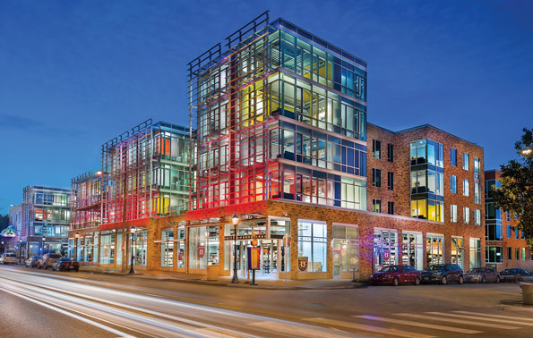

At Washington University, Sachs Electric was involved in the construction of four mixed-used buildings on a design-assist basis. Within the scope of the project, the contractor wired the retail spaces on the main floors that included a grocery store and diner. A main focus of this project was to integrate the new buildings while maintaining the eclectic look of the area, which incorporates many modern features into a historic backdrop. The contractor’s ability to use advanced lighting technologies meant achieving this look within budget (Photo courtesy of Sachs Electric).
