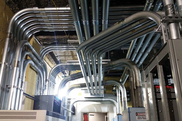

An intricate routing of conduit above the UPS and the appropriate power distribution required during a retrofit. Implementing an underground conduit plan and leaving overhead space available during the initial installation provide cost savings and decreased risk for future change.

Don’t clutter the facility with overhead pathways
The overhead space in a data center is prime real estate, meaning it can quickly become congested. In addition to your wiring pathways, overhead space needs to accommodate mechanical ductwork, plumbing, fire suppression, and structural members, so planning ahead and leaving space for future needs is critical.
The ceiling space above the data center, particularly in the electrical room, too often becomes clogged with conduit for feeder pathways. Make sure you fully utilize underground and in-slab conduit runs. By using those conduits, you can reduce collisions between trades during remodeling and save money on hangers, bending, and installation.
