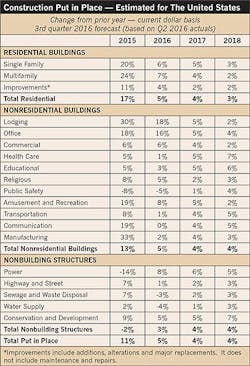

Table 2. In its third quarter 2016 construction outlook, FMI expects construction put in place to increase 4% in both 2017 and 2018 with gains across the board.
Overall, Murray expects both non-residential and residential building to increase 8% and nonbuilding construction to dip 3%. Meanwhile, Kevin Haynes, senior consultant for FMI, forecasts the growth in the residential and nonresidential markets to hold steady at 4% to 5% (Table 2).
