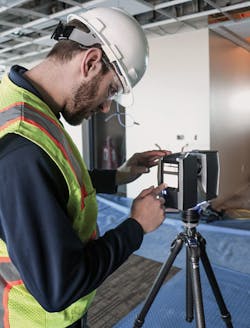

Faith Technologies’ 3D scanning operator uses the 3D scanning technology to quickly collect accurate measurements of a job site.

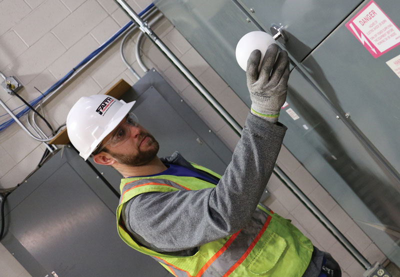

Faith Technologies’ 3D scanning operator places a target for the 3D scanning technology. The target is a reference point to create a “point cloud.”

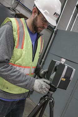

Faith Technologies’ 3D scanning operator is setting up the technology to begin the scanning process. This technology uses a laser to target a distance that is reflected back to provide a series of points in the XYZ coordinate system and ultimately represented in a “point cloud.”
This new technology uses a laser to target a distance that is reflected back to provide a series of points in the XYZ coordinate system and ultimately represented in a “point cloud.” Once a point cloud is created, you can compare it against drawings and models for validation or discrepancies between the “as-built” documents and the “as-is” 3D scan.
