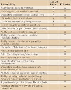

Let’s consider the difference between an electrical worker and an electrician. An electrical worker is one who can install electrical equipment when given the proper tools, materials, and information. An electrician, however, can properly perform electrical calculations, size wiring and conduits, determine appropriate wiring methods, and order the materials and tools to complete a project per applicable codes and standards like the National Electrical Code.
When we apply this same type of thinking to the estimating function, we see that a take-off person is one who can count symbols and send out fixture counts. But an estimator is one who can count a symbol and translate it into labor hours and material costs. An estimator must be skilled in reading and interpreting the project specifications. He or she must determine direct labor hours and any off-hour work and overtime required to complete various tasks.

Every position in an electrical contractor’s office requires an appropriate set of skills to get the job done. Review the list of responsibilities shown in the Table for each position. This will help you make sure that responsibilities have been assigned to the appropriate employee.
