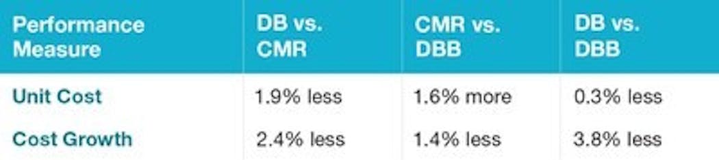

Project Cost: On average, projects using DB cost 1.9% less per square foot when compared to construction manager at risk (CMR) and 0.3% less when compared to design-bid-build (DBB). DB projects also average 2.4% less cost growth than a comparably scoped project using CMR and 3.8% less cost growth than a project using DBB.
