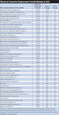

Electrical contractor & industrial employment (www.bls.gov). The U.S. Bureau of Labor Statistics updates this data on a monthly basis at the MSA, state, and national level and twice annually at the county level. Employment data can swing quite a bit from month-to-month, so you may want to use a three-month moving average to smooth out the variances.
You can learn quite a bit from this data. For example, when you look at the national numbers, at 967,233 employees at electrical contracting companies through September 2019 (three-month moving average), contractor employment is riding along at one of the highest levels in recent memory, despite the softening U.S. economy.
Note: BLS doesn’t publish electrical contractor employment data at the MSA level, so we developed our electrical contractor estimates by taking the total construction employment data available monthly at the MSA level and multiplying it by 13% ― the historical average for national electrical contractor employment as a percentage of total construction employment.
This employment data also shows you the consolidated nature of electrical contractor employment in the United States. The Top 10 markets in electrical contractor employment account for 23% of all employees, and the 100 markets with the most electrical contractor employees account for 69% of all contractor employment (see Table 4 for data on the 25 largest markets as measured by electrical contractor employment).

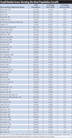

Building permits (www.census.gov/construction/bps). Building permits are a good leading indicator of future economic activity in a market because of the impact new residents have on the local economy. With new homes comes the need for more schools, new retail and commercial facilities, and virtually all other types of non-residential construction. As you can see in Table 3, Texas and Florida dominate the list of residential housing markets with the most single-family permit activity.
Population growth (www.census.gov). You will see some familiar names amongst the MSAs in Table 5, which showed the biggest increases in the number of new residents from 2013 to 2018. Leading this list are the Dallas-Fort Worth-Arlington, Texas, MSA with 722,193 new residents and the Houston-The-Woodlands-Sugarland, Texas, MSA, which added 666,727 new residents. As shown in Table 6, Bozeman, Mont. and Hilo, Hawaii led the list of smaller metros, with increases of 17,083 and 9,517 new residents, respectively.
The MSA population data also shows just how fast Texas is growing. According to U.S Census data for population growth from 2013 to 2018 the Dallas, Houston, Austin, and San Antonio metros added a staggering combined total of 1,626,371 new residents over the past five years.
