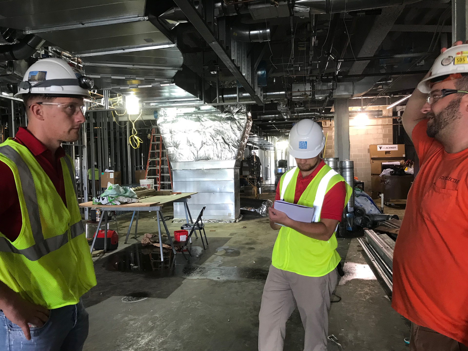

Photo 1. Collecting data through the job-site visit checklist with the foremen on-site.

It’s best to show up on the job site with a checklist (see Table below) so you can easily review the three Ms. Here are some thought starters for the visit.
  • Manpower ― What’s the crew mix? Is everyone working? What are they working on? Was it in the plan? Is there other trade interference with the work? Is the team working where they should be working? Are safety protocols in place and being followed?
  • Material ― Is the material in the right location, or is the crew having to move material to the point of installation? Is the material clean and presented to the installation crew in a ready state? Is any material damaged? Are your vendors saving you money or costing you money?
  • Money  ― Are there items for charge backs and credits? Is there a plan to recover those in a timely manner? Do you know the change-order status from a request status, a build/installation status, and an approved/paid status?
  • Use technology
    While it’s great to be on the job site to see firsthand the items listed in the checklist, you can also use software tools to tell you how the job is going when you’re not there. It is important to break a large job down into manageable and measurable tasks, ensure the team has a daily plan, and assess that the daily plan is getting done in a timely manner.
    Scheduling your team’s work and recognizing and measuring distractions is key to adapting and improving before it’s too late. It is even better when you can use the intelligence across your jobs to do lessons learned in real-time. Take your tablet with you to compare to the drawings. Take pictures of the job site, and share them with your vendors and crew. Document what you see for immediate discussion both on the job site and with the office as needed.
