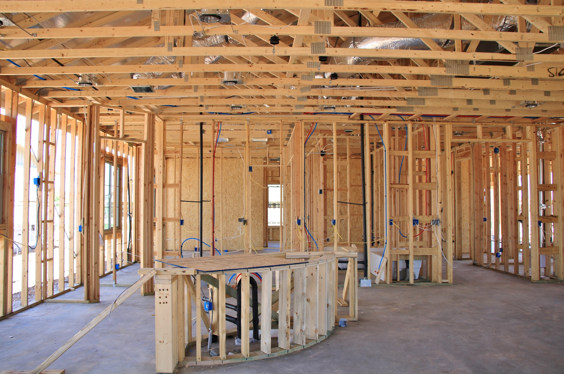

Now that the preliminary year-end building permit data for 2022 is in from the U.S. Census Bureau, we can get a good sense of which market areas will see the most home construction this year (Fig. 1). Because single-family building permits typically lead housing starts by several months, they are a dependable leading indicator of future building activity. And despite the general feeling amongst construction economists that housing starts will slide again this year before bouncing back in 2024, some local markets should see a surprising amount of housing construction in 2023. Let’s explore the key trends that will shape the residential construction market’s business climate in 2023.
