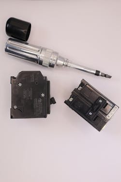

Therefore, finding the cause of the overcurrent device operation is the first step in solving the problem. A walk-through of the circuit may reveal the obvious. The smell of burnt insulation or discoloration on enclosures is definitely a suspect item (Photo 1).

Faulty terminal connections can be loose, causing voltage issues. They may eventually overheat, resulting in catastrophic failure. Make sure all terminations are tightened to their specified torque values.
Improperly tightened terminals continue to be an issue with all electrical installations. It is tempting to just “tighten up all those terminal screws.” But, if not done properly, more issues may be created. Loose terminal connections increase resistance and can cause erratic equipment operation. Applying too much torque can strip threads, distort terminals, damage the conductor, and increase resistance. Small increases in resistance values make for proportionately much larger increases in heat.
NEC Sec. 110.14(D) [Terminal Connection Torque] states, “Tightening torque values for terminal connections shall be as indicated on equipment or in installation instructions provided by the manufacturer. An approved means shall be used to achieve the indicated torque value.” Comply with the Code, follow manufacturers’ instructions, and use an approved method to verify termination torque and prevent branch-circuit overheating. See Photo 2 for one common method to verify proper torque on branch-circuit OCPDs and outlet devices — the torque screwdriver.
