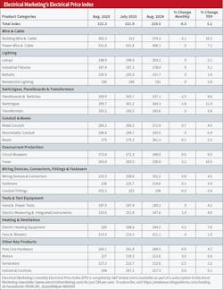

Electrical product prices are reasonably tolerable right now. But lingering uncertainties remain over which products will be affected by higher tariff rates; product areas are still seeing double-digit year-over-year (YOY) increases. According to the latest Electrical Price Index published monthly by Electrical Marketing newsletter at www.electricalmarketing.com, prices for building wire (+10.2%), switchgear (+11.9%), and fuses (+10.5%) are up double digits year-over-year through August 2025 (Table 2).

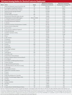

One economic trend is clear in the electrical construction market: If your company is fortunate enough to be working on data centers (or is located in one of the Sunbelt markets that seem to have perpetually sunny business climates), you are probably feeling pretty darn good about your 2026 business prospects. On the flip side, if acres of data centers aren’t being built in your local market — or if the local economy is bumping along at a slow or no-growth rate because there isn’t much new nonresidential or residential business in the pipeline — the future might not look quite so bright.
Right now, only the most pessimistic economists are calling for an outright recession in the United States, but many, if not most, will bend your ear about the “K-shaped economy,” where some segments of the overall economy are doing very well while other sectors are struggling to grow.
The electrical construction industry is a good example of the K-shaped economy in action. Riding the upper growth arm of the “K” is the data center market (growing annually at a high double-digit growth rate). Hanging onto the lower leg of the “K” with little or no growth are many other key construction market segments, such as residential and office construction and much of the industrial market (outside of semiconductor plants).
These “bifurcated” market conditions are likely to last through most of 2026, although the federal tax cuts that take effect next year (and any further cuts in interest rates) should juice up capital spending on new construction and renovation projects and make residential mortgages more palatable for many homebuyers, stimulating home construction.

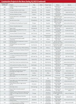

Impact of megaprojects
In ConstructConnect’s Construction Economy Outlook Fall Webcast held on November 13, Chief Economist Michael Guckes said the impact of megaprojects of $1 billion or more in total contract value cannot be underestimated — and that these jobs account for much of the growth in the nonresidential construction market.
Not surprisingly, many of these megaprojects are data centers. In the past, only the largest data centers topped $1 billion in total contract value. However, over the past year or two, the size of these jobs has increased dramatically. For example, the contract value for the proposed La Osa data center project in Eloy, Ariz., tops $30 billion, and 10 other data center projects of over $10 billion in total contract value were either in the proposal or design stage or broke ground from July 2025 through October 2025. Of the 34 megaprojects EC&M’s editors found topping $1 billion in contract value during this time period,13 were data centers (accounting for roughly 60% of their combined contract value), as shown in Table 4.

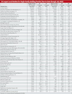

The National Association of Home Builders (NAHB), Washington, D.C., is starting to see some signs of growth in the single-family residential market and is forecasting single-family starts to increase 0.6% to 950,000 (Fig. 3). However, it sees multi-family starts declining 3.4% to 396,000.
NAHB pointed to other signs of growth in a recent press release, reporting that future sales expectations surpassed the 50-point breakeven mark in the NAHB/Wells Fargo Housing Market Index (HMI) for the first time since last January, and builder confidence in the market for newly built single-family homes was 37 points in October — up five points from September and the highest reading since April.
“The HMI gain in October is a positive signal for 2026 as our forecast is for single-family housing starts to gain ground next year,” said NAHB Chief Economist Robert Dietz in a press release. “The 30-year fixed-rate mortgage fell from just above 6.5% at the start of September to 6.3% in early October. Combined with anticipated further easing by the Fed, builders expect a slightly improving sales environment — albeit one in which persistent supply-side cost factors remain a challenge.”
