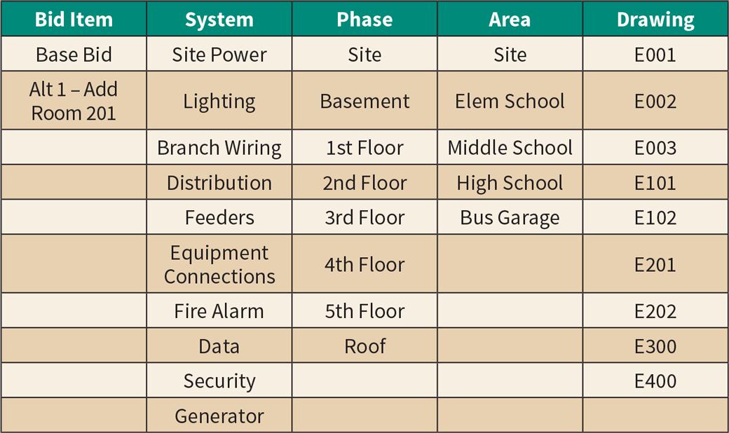

Most estimating programs allow you to structure your take-off. This structure has various names based on estimating software program you’re using. It may be referred to as labels, breakdown, or take-off tree. The estimate structure is very powerful and important when creating an estimate. It is vital that you know how the project breaks down by system, floor, area, and phase. Here are five ways in which you could break down the estimate:
• Bid Item — This should be the base bid and any alternates you come up with. This will allow you to break out any add or delete alternates. List your alternates as follows: Alt #1 – Add Cable Tray. Giving your alternates their appropriate number and description will help you keep things straight when doing your take-offs.
• System — This would include any of the systems on the project. In addition to those listed in the Table, some project systems might include: demolition, nurse call, code blue, heat tracing, snow melt, cable trays, electric heat, or area of rescue.
• Phase — This can be used for different floors on the project. Projects with sections that will be completed at various times will require a phase breakdown.
• Area — If you are bidding a project that has multiple buildings, you can use this area to identify each building on the project. In addition, you can use this breakdown to identify an area within the building such as an auditorium or gymnasium.
• Drawings — Breaking down a project by drawings can be very helpful. This is especially true if the drawings break down a project by areas. This will allow you to know labor hours per area. A sample estimate breakdown is shown in the Table.
