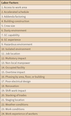

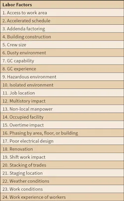

Labor factors are project conditions that affect labor productivity. Labor is to be factored to the specific type of project, environment, and installation. It might be helpful to have a worksheet and to list applicable factors and their percentages. Labor factor percentage adjustments are cumulative.
Labor factors are addressed in the bid summarization or bid recap. Since these factors can vary greatly from geographic locations and job markets, no percentages are given. The wise contractor should have a labor reporting system setup to know how these conditions truly affect labor efficiencies.
Table 2 provides 24 possible project conditions that have the potential to affect labor productivity.
