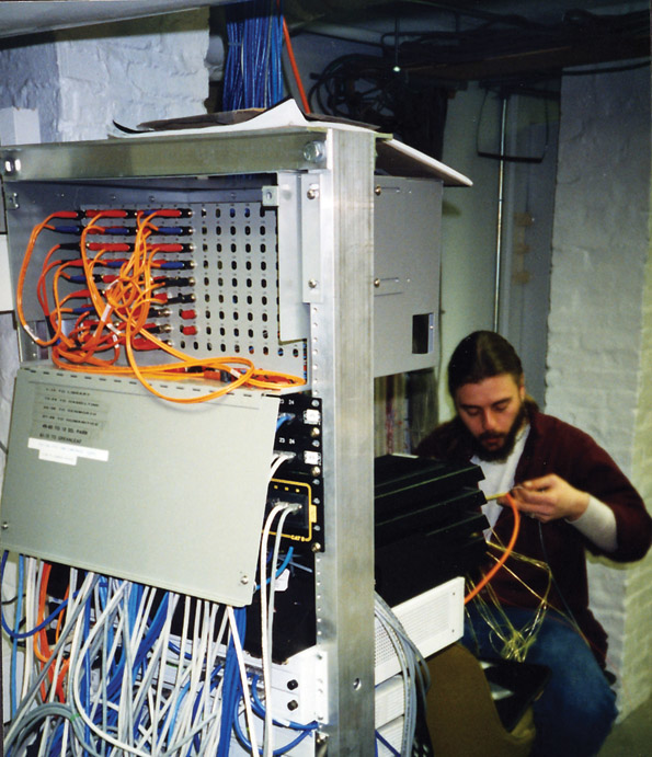

Within a commercial building, a patch panel facilitates routing to individual workstations. (Photo courtesy of the Fiber Optic Association)
