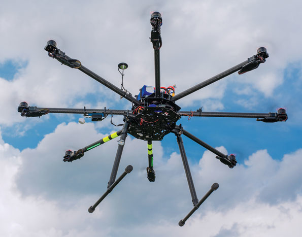

Ivey was well aware of the tech’s rise in popularity — today he owns six drones — and its expanding capabilities. Chief among them: You could strap a Go-Pro to one of the units before sending it aloft, turning it into a literal eye in the sky. And then there was the cost of operation. Hiring a helicopter to survey anything from the air or to record footage can run you upwards of $1,000 an hour. With a drone’s low cost of ownership, though, the hourly rate for that same kind of work could be just a fraction of the cost. That’s when Ivey started putting two and two together: Owners and operators of large PV arrays may not have known it then, but one day very soon they were going to benefit greatly from drones — or from anyone who knew how to fly them.
