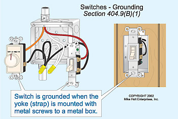

Q. When installing switches on a metal box, are a ground tail or self-grounding switches required or are the switch screws suitable for grounding the switch to the metal box?
A. The metal switch mounting screws provide the required low impedance ground-fault current path required to the metal box [404.9(B)(1)]. Therefore, a bonding jumper or “self-grounding” switch isn't required (Figure below).
