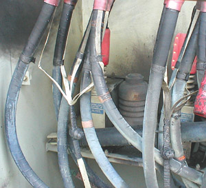

The two most important concerns at 4.16kV are standing line voltage and line faults. Both can cause the outside of a non-shielded cable to develop a potential, which could pose a danger to anyone who touches it. One concern is that when a 5kV non-shielded cable is operated at 4.16kV, the surface of the cable isn't at zero potential. A standing voltage always exists and could, under certain conditions, be high enough to pose a danger to anyone who comes in contact with it.
A second concern is that if a non-shielded cable fails, the cable's jacket could become energized and the relay protecting the cable might not trip out of service. If a person were to grab a faulted cable, they could create a path to ground, which could easily result in injury or death. The conductive layer in the shield provides a return path to ground. If a fault does occur, relays can detect the current flow in that layer and de-energize the cable.

How to properly ground shielded cable. To ensure positive continuity from one end of the cable to the other, the shielding of each cable should be grounded at both ends and at each splice. Where grounding conductors are part of the cable assembly, cable manufacturers recommend that the shielding be effectively grounded at both ends of the cable. For short lengths of cable, or where special bonding arrangements are used, grounding at only one point may be satisfactory. However, if operating conditions permit, it's desirable to bond and ground cable shields at more than one point to improve the reliability and safety of the circuit. This decreases the reactance to fault currents and increases the human safety factor.
