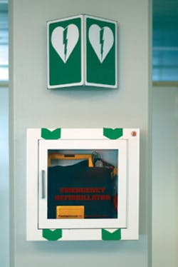

Today, automated external defibrillators (AEDs) are becoming increasingly affordable for laymen, with an average price of just more than $2,000, according to the American Red Cross. Used to treat cardiac arrest, an AED automatically analyzes the patient's heart rhythm and advises the rescuer whether or not a shock is needed, according to the U.S. Food and Drug Administration (FDA), which advises that the device should not be used in a patient who has a pulse or cannot be isolated from other people.
A physician's prescription is needed in order to purchase most AEDs. According to the Red Cross, this means that the medical director of a facility or a physician used by such facility must prescribe and oversee the AED program at any workplace or other facility that houses an AED, though some AEDs can be purchased over the counter without a prescription.
