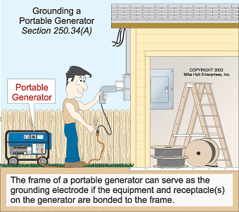

Q. Let’s say a 5kW generator supplies only equipment mounted on the generator, cord-and-plug-connected equipment through receptacles mounted on the generator, or both. Should the generator have a ground rod connection? A point on the frame of the generator marked "ground" makes me think so.
A. No, a ground rod is not needed, not required, and would serve no purpose [250.34(A)]. This manufacturer provided a ground lug on the generator because it doesn’t know any better.
CAUTION: Creating a bonding jumper connection at both the source and the first disconnecting means will create a parallel path, allowing dangerous neutral current to flow over the grounding conductors or grounding paths, which is a violation of 250.6.
