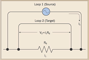

Q. We're experiencing problems that I'm told are caused by electrical noise. What causes electrical noise and what can be done to eliminate it?
DeDad's answer: Electrical noise can be caused by ground loops, which occur most often in circuit returns (Fig. 1 on page 24). Another cause is capacitive coupling, where the noise is capacitively picked up mostly in high-impedance circuits. Inductive coupling can also be a culprit, where a changing magnetic field is created around a wire carrying alternating current. The noise is transferred through air to another wire close by (Fig. 2 on page 24).
You can't completely eliminate electrical noise but you can reduce it to “tolerable” levels. Basically, each practical noise-reduction action you take will result in less noise. Some viable noise-reduction strategies include the following:
  • Reducing the amplitude of the noise by raising the impedance to it in the harmful direction.
  • Shunting the noise away by lowering the impedance to it in a benign direction.
  • Breaking the link between the noise and the affected circuit.
