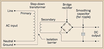

Sidebar: The Basics of a 3-Phase Power Supply
As noted in this schematic of a typical power supply, AC and DC ground connections are isolated from one another.
Most power supplies come with an AC power input connection that incorporates line (L), neutral (N), and earth (E) connections. The E connection, also referred to as the ground (GND) or protective earth connection, normally ties into the frame (in an open-frame design) or the housing (if enclosed). Voltage conversion in the power supply occurs through a step-down isolation transformer with a 5:1 ratio, specifically 120:24. The DC output terminations become isolated from the input because of transformer isolation.
The basic internal layout of a power supply is shown in the Figure above. Note that the grounding of the iron-core transformer normally feeds into the incoming AC voltage. The corresponding step-down voltage, which is DC after full-wave rectification, is isolated from the input terminations.
