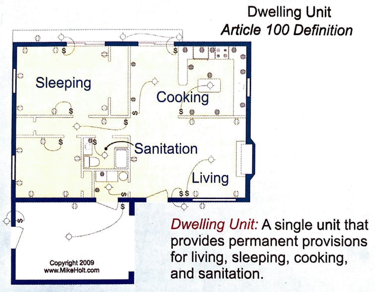

A dwelling unit is a single structure that provides complete and independent living facilities, according to the NEC definition found in Art. 100 (Fig. 1 ).
