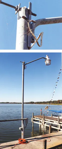

Dock Lighting System
The electrical circuit supplying the light pole on this dock set up a rather unique installation. First, the electrical conduit served as a fence or railing for pedestrians. In addition to the missing covers on the conduit bodies, which leave exposed live wires accessible to the general public, there were exposed conductors at the top of the pole. In the close-up photo, you can see the cable isn't designed for this use. To top it all off, the equipment-grounding conductor is also missing. Per 410.15, metal poles are permitted to support luminaires and serve as a raceway to enclose supply conductors, provided the pole has a hand hole not less than 2 in. × 4 in. with a raintight cover to provide access to the supply terminations within the pole or pole base.
