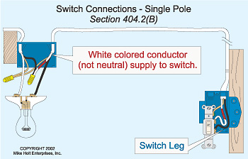

Some like it hot. Switches are wired to make or break the supply conductor — also called the hot lead. The NEC specifically bars switching the grounded (neutral) conductor or the grounding conductor [404.2(B)] (Fig. 1 at right).
Thus, for a simple on/off operation of a 120V light, the switch contacts must be wired in series with the hot lead. In other words, the hot lead comes from the supply to the switch, and then goes from the switch to the light. The neutral and ground wires aren't switched, but you must ground the switch body.
This same hot wire logic carries over to three-way and four-way switches. When you wire in such a configuration, you're still switching only the ungrounded (hot) conductor [404.2(A)] (Fig. 2 at right).
In applications where you're pulling wires from spools into raceway, the black wire is hot, neutral is white (or gray), and the ground is green or bare. You could use some other color for the switched hot, if you desired. But what if you're using a three-wire cable?
Residential applications typically use nonmetallic-sheathed cable for all circuits. Industrial and commercial applications often use some type of metallic cable assembly for 120V power distribution — for example, when deploying pre-fab “snap-in” construction methods. If you're running a cable assembly, how do you wire for a switch? After all, you have only one black wire in that cable.
You can use the white or gray conductor within a cable assembly for single-pole, three-way or four-way switch loops if it's permanently re-identified to indicate its use as an ungrounded (hot) conductor at each location where the conductor is visible and accessible [200.7(C)(2)].
