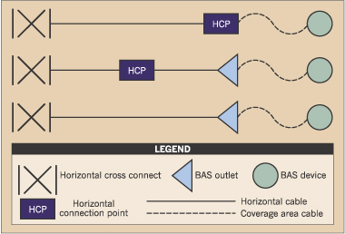

Within the horizontal cabling run, the ANSI/TIA/EIA-862 standard introduces two terms not found in TIA/EIA-568: horizontal connection point (HCP) and coverage area cable. The HCP is similar to the consolidation point (CP) used in open office (zone) cabling in TIA/EIA-568-B.1, since both are located somewhere in the horizontal cabling run between the telecommunications room and the user/device. Coverage area cable is the portion of the horizontal cabling that connects either the BAS outlet or the HCP to the BAS device.
With a telecom system in the 568 standard, a CP can be used to provide a cross-connection function between the telecommunications room and a telecom outlet. With a BAS system in the 862 standard, an HCP can be placed between the horizontal cross-connect in the telecom closet and a BAS device. The horizontal cabling from the HPC can also go to a BAS outlet and then to a BAS device. Of course, the cabling can also run directly from the horizontal cross-connect to a BAS outlet and then to a BAS device. Fig. 1 on page 41 shows the three BAS horizontal cabling options. In all cases, the distance limitation is 90 m.
As with the TIA/EIA-568-B standard, ANSI/TIA/EIA-862 calls for the HCP or BAS outlets to be wired in a star topology from the telecommunications room, although bus or ring layouts are also possible, using multi-point connections.
