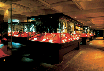

What has made the technology so attractive to lighting architects designing installations in places like art galleries and museums where the items on display can be ruined by excessive, intense light is the virtual nonexistence of heat or UV rays (Photo at top). Because the tails carry light by reflection, they leave the heat and damaging rays behind at the source. This same characteristic makes it possible to use fiber optics under water in pools and fountains because they do not conduct electricity.
