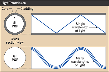

Most POF is called step index fiber (SI-MMF), which has a fiber diameter of 1 millimeter, or 1,000 micrometers, and a core diameter of 980 micrometers. Generally, polymethacrylate (PMMA) and acrylic resins are used as the core material, and fluorinated polymer is used as the clad material. One manufacturer offers a premium POF with a core of high-purity polymethyl methacrylate and a cladding made of special fluorinated polymer.
POF can be cut with a razor blade, and the cut end can be polished without much effort. Plastic fiber can be terminated by a variety of methods. One popular method involves heating the fiber end and pushing it against a mirrored surface.
The material can withstand rough treatment, and if the ends of the fiber are somewhat damaged or if the light axis is a bit off-center, it will still transmit light. The large diameter of the core makes it easy to insert into the fiber a large amount of light from a relatively inexpensive light source. POF optical transceiver modules typically use a 650-nanometer red LED as the light source. In addition, typical POF connectors cost substantially less than those for glass fiber.
SI-MMF has a loss of 0.15-0.2 decibels per meter with a 650 nanometer light source. Bandwidth is limited by the large numerical aperture of the core and the step-index profile. All of these parameters restrict SI-MMF fiber to relatively short links at low data rates. But the recent development of low-loss, high-bandwidth graded-index POF (GI-POF), which can offer 2 GHz of bandwidth at extended distances, should allow plastic to challenge glass optical fiber. Not only that, GI-POF could become a contender in applications like fiber-to-the-desk, fiber-to-the-home, and other short-haul links.
