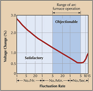

Sensitivity curves for incandescent lighting show how the voltage fluctuations can cause unacceptable variations in light output. The curve shown in Fig. 1 above is one example of a flicker sensitivity curve for an arc furnace load. It's based on the response of the human eye and brain to variations in the light output from a 60W incandescent bulb caused by fluctuations in the supply voltage.
Characterizing flicker. Many utilities have adopted a curve similar to the one in Fig. 1 to evaluate the acceptability of a customer load that causes voltage fluctuations. However, in order to use the sensitivity curve in Fig. 1, the voltage fluctuations have to be step changes in voltage at a constant frequency of occurrence. This is very seldom the case for randomly changing loads like those associated with arc furnaces (Figs. 2a and 2b).
