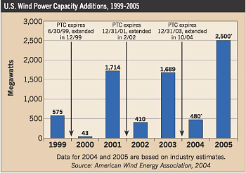

    Although significant technological advances throughout the last decade have brought down the capital costs of wind energy, it has trouble competing with fossil fuels, making the tax incentive a must-have to get most large projects off the ground. And the wind energy market's movements over the last five years bear out that fact. When the PTC lapsed in 2000, 2002, and 2004, 43MW, 410MW, and 480MW of capacity were installed, respectively (Table). Installed capacity reached about 1,700MW in 2001 and 2003 when it was in effect, and predictions for 2005 range anywhere from 1,400MW to 2,500MW.
    The statistics show the PTC's intermittency is almost single-handedly responsible for that boom-bust cycle, and many believe wind would account for a much larger portion of the nation's energy supply had a consistent policy been in place. By the end of 2004, U.S. wind capacity had reached almost 6,800MW — about 1% of the nation's total. Given the flurry of activity that has followed previous extensions and the fact that the credit will expire again at the end of 2005, the wind market is poised for a busy year, but experts worry that the market will struggle to gain a good footing without a stable PTC.

    AWEA claims the problems caused by the PTC's stop-start nature could be solved with a long-term extension. First passed in 1992, the PTC was only meant to last for seven years, but when it was clear it had helped wind energy gain traction in 1999, the industry pushed for an extension. Two years was the most Congress could ever justify, bringing about the on-again/off-again cycle. Real de Azua says at least a five- or 10-year extension is in order. “We've been trying to argue for that and make members of Congress understand the cost and difficulty these short-term extensions create,” she says. “If there were a longer term extension, you would minimize the cost of those cycles or take them away altogether.”
