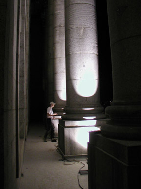

Mock-ups: It is not unusual for a full-scale lighting mock-up requirement to be included by a lighting designer in the project's specification (Photo 1 above). Complex or sensitive design solutions may include variables that can only be resolved after review and analysis of an operational mock-up. Due to the compression in design schedules, and the increased popularity of design-build construction contracts, the incorporation of such a mock-up early on in the construction phase (rather than during the design phase) is not uncommon. The lighting designer will normally outline the intent of the mock-up and define the requirements for the contractor's execution of the work. Once again, open collaboration between the lighting designer and contractor is key to full realization of the mock-up's intent.
