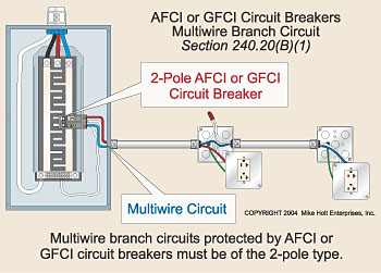

Q. Can a single-pole AFCI breaker be installed on a multi-wire branch circuit?
A. No, because it won't work. You'll need to use a two-pole AFCI for this purpose, just like you would if the circuit was to be GFCI protected (Figure below).
