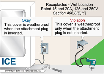

Q. What are the requirements for installing 15A or 20A receptacles in wet locations?
A. All 15A and 20A receptacles in wet locations must be placed within an enclosure that's weatherproof and remains weatherproof when an attachment plug is inserted in the receptacle [406.8(B)] (Fig. 1). According to Art. 100, a wet location would be an area subject to saturation with water or an unprotected location exposed to weather.
