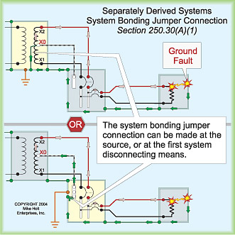

Q. Where must the system-bonding jumper at a transformer be installed?
A. The metal parts of the separately derived system must be bonded to the secondary grounded neutral terminal by the installation of a system-bonding jumper. This bonding jumper ensures that dangerous voltage from a secondary ground fault can be quickly removed by opening the separately derived system circuit's overcurrent protection device [250.2(A)(3) and 250.30(A)(1)].
Danger: During a ground fault, metal parts of electrical equipment, as well as metal piping and structural steel, will become and remain energized and thereby provide the potential for electric shock and fire if the system bonding jumper isn't installed.
The system-bonding jumper can be installed at the transformer, the first system disconnecting means, or any point in between the transformer and the first disconnecting means, but not at both locations (Figure at right).
Caution: Dangerous objectionable current will flow on conductive metal parts of electrical equipment as well as metal piping and structural steel, in violation of 250.6(A), if the system-bonding jumper is installed at the transformer and the secondary system disconnecting means.
