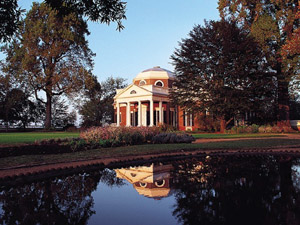

While thousands of historical renovations are currently underway throughout the United States, this article will profile two landmark projects — the preservation of Monticello, President Thomas Jefferson's home that was built in 1770 and the rehabilitation of '30s government buildings in the Federal Triangle in Washington, D.C. While a preservation project like Monticello focuses more on the ongoing maintenance and repair of historic materials, the term rehabilitation refers to the transformation of a historical structure into a usable building. In addition to highlighting these projects, this article will also offer eight tips that your company should keep in mind when working on a historic property.
Illuminating Thomas Jefferson's Monticello. President Thomas Jefferson designed Monticello, his mountaintop estate in Charlottesville, Va., with skylights and large windows so sunlight would flood into all of the interior rooms. Today this historic property, owned by the Thomas Jefferson Foundation, is furnished almost entirely with Jefferson's original possessions, including furniture, paintings, and other decorative arts. To protect these priceless artifacts from the damaging effects of UV and visible light, solar shades were installed in 1993. These shades, which are suspended in front of all the windows, block out 99% of UV light and 85% of all visible light. Because so much visible light was being screened, it became necessary for guides giving tours to use flashlights during the late afternoon or on cloudy days. This was especially true during the winter months, when daylight hours became shorter.
In order to better showcase this landmark, the restoration department hired George Sexton Associates, a Washington, D.C.-based lighting design firm, in 1994 to design a lighting scheme for Monticello. Working with the curatorial and restoration departments, the firm designed a system using a combination of 12V lighting and 120V fixtures. Up until this time, there had only been one electrical outlet on the entire main floor. A local electrical contracting firm, Design Electric, was hired to install additional wiring for the new system. Eric Hartwig, a master electrician, and Tom Phillips, a journeyman electrician, brought wiring down through the chimney flues that had been closed up in the mid '50s to serve as returns for the HVAC system. They also installed receptacles in the throats of the fireplaces. Not every room had a fireplace, however, so they brought wires up from below in some locations by taking advantage of holes that had been drilled through the floor in the late 19th century for a hot water radiator system.
“The main strategy was to avoid doing any damage at all to the original fabric of the building when running this new wiring,” says Bob Self, architectural conservator for the restoration department. “When we wanted a power source where there wasn't a fireplace, we brought up wiring from below, choosing areas that had been patched or plugged previously.”
Monticello features several formal rooms with 18-foot ceilings. As a result, the electricians were able to take advantage of the space in the attic to install a 12V lighting system. They mounted the transformers, ran the associated low-voltage wires, and installed strip lighting on the skylight ledges in the dining room and Jefferson's bedroom, above a door pediment in the parlor, and on a ledge in the Tea Room.
“We tried to introduce light without having fixtures that could actually be seen,” Self says. “You have to look carefully to see where the light is coming from.”
When it wasn't possible to conceal the fixtures, the electricians installed 120V circuits for plug-in fixtures. In Jefferson's time, natural sunlight, candles, and oil lamps were used rather than electric light fixtures to illuminate buildings. In some spaces, because of the amount of light needed, it was necessary to accept modern fixtures, such as torchieres. To solve the problem of providing light in an inventive manner, Susan Stein, the curator at Monticello, decided to experiment by using a type of lamp that was owned by Jefferson. The Argand oil lamp, invented in the 1780s, gave off more light than traditional oil lamps due to a cylindrical wick that allowed airflow around the flame. Monticello now displays these two lamps on the mantelpiece in the dining room, which also has additional lighting provided by the strip lighting on the skylight ledge.
“A pair of lamps of the right period was purchased and then wired externally without damaging them in any way,” Self says. “The result is an original fixture, but with a modern electric bulb.”
During the wiring project at Monticello, the electricians carefully avoided doing any damage to the original structure. They worked closely with Self to determine the best places to run wiring and install the fixtures. All of the wiring is completely reversible and could be easily removed, leaving little evidence that it has ever been in place, Self says.
