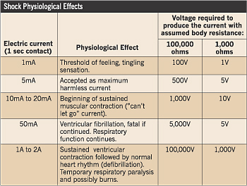

The ability of an electric shock to cause damage to the human body is a function of skin resistance, voltage, the path the current travels, and to a lesser extent the frequency of the electricity. As it turns out, the type of electricity that most people come into contact with daily, albeit safely, can be the deadliest given the right circumstances. The Table above explains how much voltage, skin resistance, and resultant current is necessary to hurt the human body. Given enough moisture on the skin, a 120V, 15A 60-Hz jolt that travels through the chest cavity is sufficient to send the heart's lower chambers into a rapid unsynchronized fluttering called ventricular fibrillation, or v-fib, that renders it unable to pump blood to the rest of the body. With its usual form of transportation shut down, oxygen fails to reach the body's cells — most importantly, those that constitute the brain — and they begin to die. The medical community's best estimates offer an electrical shock victim whose heart has entered v-fib four minutes before death in the absence of medical attention.
Ironically, excessively high currents are less likely to do catastrophic damage to the heart. Such currents will cause the heart to tighten like a clenched fist — a condition called ventricular seizure — and if the victim is knocked clear of the power source, the heart can actually restart itself.
It's at that point on an imaginary risk chart where the lines representing resistance, voltage, current path, and frequency converge — coincidentally the same recipe of electricity most electrical workers are exposed to — where electricity can be the deadliest. And in those brief moments after ventricular fibrillation that are book-ended by life and death, the simple act of applying pressure to the chest in short, timed thrusts with the palms of your hands can give an otherwise helpless victim a chance at survival.

Electricity's behavior is bound by Kirkhoff's and Ohm's laws, but its effect on the body can never be predicted with any level of certainty. In some cases, it's possible for a worker to receive a lethal shock and appear fine for several minutes before suddenly suffering a heart attack and dying. Such instances are rare, but Morse stresses that this unpredictability is all the more reason to take any electrocution seriously and seek medical assistance even if the victim appears to be fine. “That may be the overly cautious view, but considering the fact that the only other option is death, it's a lot better to make the mistake of going to the hospital or calling an ambulance than to watch a shock victim keel over and die before help arrives.”
The most common scenario, however, is instant defibrillation and collapse. Because the effects of electric shock are so similar to that of a heart attack, it can be difficult to identify what caused the victim to collapse. But because the treatment is the same in either case, it isn't necessary to worry about making such a distinction. “The heart fibrillates, the body de-oxygenates, the person collapses, and within 15 seconds they're unconscious,” Morse says. “To a person who walks into the room five seconds after the shock, it appears to be a heart attack.”
