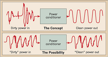

Be careful with your recommendations; make sure you follow these rules: * Weigh the gathered data and possible solutions with the needs and tolerances of the affected equipment. Many power quality investigators have found that offering general recommendations to particular problems came back to haunt them. One example of this is the general practice of recommending an IG wiring system to counter a perceived electrical noise problem affecting computer equipment. Electrical noise on a grounding system may, in fact, be the result of shared power distribution with non-sensitive loads, the length of branch circuits, or improperly wired outlets -none of which will be corrected by an isolated ground. * If you can, provide your client with more than one sensible solution to the problem. Remember, some solutions may have a higher initial cost but result in a long-term benefit. * Urge the resolution of any wiring and grounding deficiencies before applying power conditioning equipment. * Keep in mind you may have to provide some type of simulation for harmonics or transient analysis.
