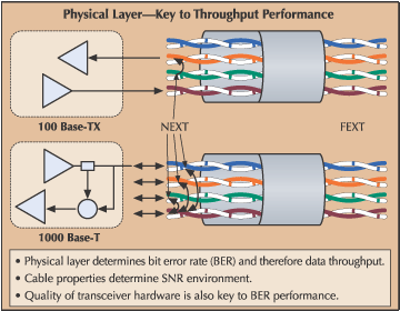

Can ordinary Cat. 5 cabling infrastructures carry GbE? This debate has been raging for two years. The problem is Cat. 5 cabling systems are designed to operate over only two pairs of a 4-pair cable — one pair serving the transmitter and one pair the receiver.
To move gigabits of information over a medium designed to carry megabits, GbE uses all four pairs of the cable and requires bidirectional transmission, with a transmitter and receiver transmitting on each pair. If you do the math, you'll see that each pair must still carry 250 megabits/sec on a cable designed for 100 megabits/sec. The cable makes up the difference by using sophisticated data-encoding schemes designed by electronic engineers to place multiple bits of data on a single hertz of bandwidth (see Sidebar below).
Using all parts of a 4-pair cable for bidirectional transmission as opposed to using two pairs for transmission in one direction places far higher demands on the cable. The debate over whether or not ordinary Cat. 5 cable can carry GbE stems from the fact that both the quality manufactured into such cables and the expertise and craftsmanship with which they are installed have consistently improved over the past five years. The obvious conclusion is some Cat. 5 installations can carry GbE, but the only way to find out if yours is one of them is to test it (see Table 1 above).
Escalating category race. Manufacturers of Cat. 5 cable recognized early on that there would soon be a need for bandwidth greater than 100 MHz. Many of them began offering Cat. 5 labeled “enhanced” or “extended-performance.” Major voice/data distributors, such as Anixter with its Levels program and Graybar with its VIP program, also established higher performance standards than the Cat. 5 minimum identified in the ANSI/TIA/EIA-568 series of cabling standards.
Soon the Telecommunications Industry Association (TIA) followed suit with a subcategory of Cat. 5, labeled Cat. 5E. Cat. 5E cable has to pass additional tests for electrical performance specifically designed to accommodate GbE. For example, a near-end crosstalk (NEXT) test for Cat. 5 cable measures the crosstalk disturbance on a wire pair caused by each of the other three pairs of the cable in turn, and establishes whether or not the cable passes or fails the test on the basis of the electrical performance of the worst pair-to-pair combination. This is an appropriate test for systems operating over two pairs, as standard Cat. 5 systems do.
However, GbE systems require a different testing procedure because they use all four pairs bidirectionally. The appropriate approach for GbE tests is power-sum testing, which measures the total crosstalk effect of three transmitting pairs on the remaining pair in a 4-pair cable. In addition to power-sum NEXT (PS-NEXT), Cat. 5E networks must also pass other tests not required of Cat. 5 networks: equal-level, far-end crosstalk (ELFEXT); power-sum ELFEXT (PS-ELFEXT); and return loss (Fig. 1 on page 80).

Physical layer is the key to throughput. Fanny Mlinarsky, general manager of the WireScope Operation of Agilent Technologies, Palo Alto, Calif., had a similar take on network performance. She suggested today's bandwidth-hungry business applications — such as informational broadcasts, distance learning, video telephony and conferencing, and tele-medicine — demand a low BER, and “it is the physical layer that determines BER, and therefore data throughput.”
High-quality transceivers, the right kind of cable, and proper network configuration and operation are also important factors in quality of network service, but, Mlinarsky concluded, “the integrity of the physical layer is the foundation and key to good throughput performance.”
