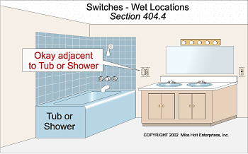

    Q. How close to a shower stall or hydromassage bathtub can I install a switch?
    A. You can't locate switches within the wet location of a tub, shower space, or hydromassage tub (404.4 and 680.72). However, you can locate switches next to the tub or shower space. On a side note, switches must be located at least 5 feet from pools, spas, and hot tubs [680.22(C)] (Figure below).
