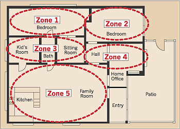

Design aspects of alarm systems. The key element of a good security system design, installation, and configuration is the zoning and zone layout of the various sensors and cameras in the network. A zone, such as the master bedroom, may comprise a door sensor and window contacts specific for that room. Similarly, another zone may include closed-circuit television (CCTV) cameras mounted at the front and rear doors of the home. Still another zone may include the upstairs and downstairs smoke detectors and carbon monoxide detectors (Figure). The building plan and homeowner requirements are major factors in the determination and selection of the number and size of zones in the home.

The sensor switches used in each security zone can be configured in one of two ways:
  • Normally closed (NC). When the system is in protected mode — a closed window or door — the sensor switch contacts are connected and the system is armed. In this configuration, the opening of an NC device will set off an alarm.
  • Normally open (NO). In this configuration, the closing of a sensor switch contact will set off an alarm.
Most security alarm systems will allow for an NO or NC zone configuration, or a hybrid of the two.

For hardwired systems, wires are terminated on one end at the security panel and on the other end at each motion sensor, camera, keypad, and window or door contact. As noted earlier, the wiring is usually configured in zones using a star or homerun topology.
The sensor switches for an NC zone are cabled in a series-connected loop by running one of the zone wires through each of the sensor switches, in series, and returning back from the last switch to complete the zone loop. On the contrary, when NO contacts are used the zones are wired in parallel.
There are two important considerations to take note of regarding each of these two connection methods:
  • An NC loop (zone) may pick up less noise than an NO zone.
  • Provided both aren't cut through simultaneously, the alarm will not go off if an intruder cuts through the wires of an NO zone. This isn't the case with an NC zone-wired design.
