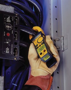

Because the display is typically on a clamp meter's face, it can be tricky — and dangerous — to read when you have to reach to the back of a cabinet or above your head to clamp on to a cable. In addition to a standard display on the face, Ideal's new meters sport one on the bottom, making it possible to view the reading in real-time without putting your head or any other part of your body in harm's way.

As the plant engineer and maintenance supervisor for Perfect Equipment in La Vergne, Tenn., Nick Nokes considers himself a very hands-on member of the electrical team. He spends the majority of his time on the plant floor, and even though he doesn't regularly put himself in precarious positions to read his clamp meter, he could still benefit from the new display. “I wish somebody would have thought of that before,” he says. “A lot of meters have a hold feature, but that's not real-time. If you're looking at it and trying to diagnose the problem in a high-current area, it's much better to see it in real-time than a snap-shot for just a split second.”
Nokes had the opportunity to test the meter long before it became available to the public. A representative from Ideal brought a sample of the 600A meter to the Perfect Equipment plant in May, and Nokes put it to work right away. “I clamped it on to a 400A service cable and just flipped open the end cap and looked at the display to get the reading,” he says. “It was great because I didn't have to get a step ladder out to get up and look at it.”
