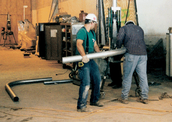

Examine each activity to see if you can improve efficiency. For example, if your people bend much conduit with hand benders, consider a powered conduit bender or pre-fabbed bends. If you do much field fabrication, set up a workbench or cart with a vise and expected job equipment. If you do many wire pulls, use a spool reel. These minor investments in equipment can eliminate fatigue and improve worker productivity.

Field supervisors often pull people off one task to do another, and before that task is done, the worker has been assigned to yet another. Or they suddenly realize the critical path is behind schedule and then put so many people on a task that they get in each other's way. The cure? Prioritize tasks. Assign the correct-sized crew to each task, moving down the list of priorities. Have crews tackle the most difficult or most dangerous high-priority items early in the day while they still have the energy and attention span required (Photo 1 above). Do the easier tasks later when fatigue sets in.
