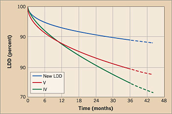

In 1999, The interNational Association of Lighting Management Companies (NALMCO) completed a three-year, EPA-funded study of luminaire (lighting fixture) dirt depreciation. Analysis of the results indicates that existing light loss factors, related to dirt and dust buildup on fixture surfaces, used by the lighting community for more than 50 years overestimate the extent of light loss, particularly in cleaner spaces such as offices, schools and retail spaces.
The study indicates that in a typical commercial indoor environment, the extent of dirt depreciation on light fixtures isn't as high as the accepted norms used in the past. In the time frame of a two- to three-year cleaning cycle, for example, the new findings recommend allowing for about a 10% loss for many areas, as opposed to a 20% loss cited in present lighting standards.
The controlled LDD field study included more than 200 sites at office, retail, and school facilities in the United States, and looked at four popular recessed fluorescent lighting fixture types: 2×4 lensed, 2×4 louvered, 2×2 louvered, and 2×4 air exhaust louvered. Based on some estimates, these fixtures collectively represented about 90% percent of recessed fixtures in operation in the United States in 1995. The split between lensed and louvered fixtures in the study was about 50-50.
The Figure above contrasts the new LDD function with lensed and louvered fixtures in clean conditions. It assumes better-than-average air filtration and some generated or ambient dirt. At 18 months, the LDD factor is 0.92 versus 0.84-0.85 using the traditional IESNA procedure. And at 36 months, the LDD factor is 0.89 versus 0.75-0.80. Lensed and louvered fixtures show virtually identical dirt depreciation, and variable operating hours per year have negligible effect, according to the study.
This LDD data can significantly affect lighting design of commercial facilities where fluorescent, flat-bottomed, and recessed or ceiling-mounted fixtures are installed.
“Test results indicate that in very clean locations, about 8% to 10% fewer fixtures are required to provide a specific light level, compared to using design calculations with earlier LDD values,” says Norma Frank, CLMC, chair of the IESNA Maintenance Committee and vice president of Colorado Lighting. “Renovation projects in older facilities would result in the order of 15-20% fewer fixtures if this new data is utilized.”
The LDD study results have been incorporated into a new IESNA Recommended Practice on Maintenance (RP-36) and will be published in the IES Handbook.
