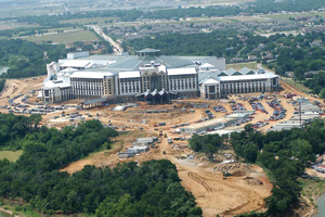

Overlooking Lake Grapevine and surrounded by open pasture, the $515 million facility opened in April after nearly three years of construction. Like the Gaylord Opryland in Nashville, Tenn., and the Gaylord Palms in Orlando, Fla., the Gaylord Texan features the company's signature resort-under-glass design. To capture the spirit of Texas, HBG designed the facility with a 72-foot wide star located in the cupola of the main atrium skylight. A river also flows through three distinct theme areas — the Palo Duro Canyons of Texas, Texas Hill Country, and the San Antonio Riverwalk. The team is now in the preconstruction phases of the Glass Cactus entertainment complex, which will serve as a venue for Texas singers and songwriters as well as other headline acts.
